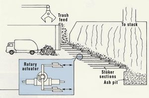

Figure 1. Hydraulic rack-and-pinion rotary actuators drive stoker assembly that boosts performance and reduces emissions of resource recovery incinerator.

The combustion process involves coordinating over-fire and under-fire air flow, refuse feed rate, and stoker speed in combustion sections of the furnace. Stokers are large grates that agitate refuse in the furnace to promote uniform burning and advance refuse through the furnace by pushing refuse down a series of steps. These moving steps are created by the reciprocating motion of the stokers, Figure 1. Rack-and-pinion rotary actuators move three pairs of stokers back and forth.
