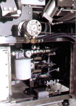

Servo-controlled cylinder has external magnetostrictive piston-position sensor. Peppamatic automatic pepperoni-slicing machine assures complete portion and weight control of topping for pizzas. Valve compartment holds servo, ...

Servo-controlled cylinder has external magnetostrictive piston-position sensor. Click on image for larger view.
An electronic motion controller coordinates the slicing heads and the conveyer. While a nickel-plated Parker Nichols hydraulic motor, controlled by a Parker Hannifin D1FX proportional directional-control valve, powers the conveyor, an optical encoder with quadrature output provides position-feedback signals to the controller.
A pair of Parker Hannifin cylinders, one on each slicing head, await individual commands from Parker electrohydraulic servovalves. The cylinders are fitted with externally mounted Temposonics II magnetostrictive position sensors. (Such sensors frequently are installed in a cavity bored in the piston rod, but these 1-in. pistons have only 5/8-in. diameter rods.) By electronically slaving the Temposonics sensors to the optical encoder, the motion controller strokes each slicing head cylinder at the exact moment that the conveyor delivers a crust underneath it.
An integral power unit supplies the 1,000-psi hydraulic system. Because of the high speeds involved, the Peppamatic 1514-2 drives its Parker variable-displacement piston pump with a 15-hp electric motor. Another hydraulic function actuates cylinders that raise the machine's heavy top assembly to facilitate cleaning. (The USDA-approved machine is designed for washdowns using harsh commercial sanitizing agents; stainless steel, Delrin plastic, and hard-coat anodized aluminum are among the materials.)
