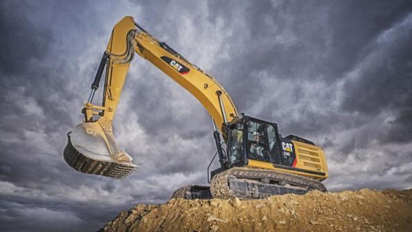

Hybrid technology for most people conjures up visions of fuel-efficient cars with conventional gasoline power supplemented by electrical power. For those of us involved in the fluid-power industry, however, hybrid usually means hydraulic, where accumulators — not batteries — store energy. That’s the case for Caterpillar’s 336E H hybrid excavator.
The hybrid option adds about 9% to the cost of a conventional 336E. That’s a substantial amount, but smart buyers will realize that they will quickly recover an even more substantial amount in fuel savings. In general, the payback period is about 2,000 hr of operation. Furthermore, the hydraulic hybrid drive carries a much lower price add-on than an electric hybrid drive would. That’s because the hydraulic version doesn’t carry the high price tag associated with electrical generators, motors cabling, and other components required for electric hybrids.
Caterpillar’s 336E excavator comes with a hybrid hydraulic option that offers dramatic fuel savings, making its return on investment more attractive to buyers than the ROI for an electric hybrid.
The 336E H captures and reuses energy in its swing drive, which holds high potential for saving energy. In a typical scenario, an excavator digs earth from the ground, raises it, then swings about 90° to dump the material. So by storing braking energy in accumulators at the end of each dig-and-dump operation, the swing drive can recycle most this energy for acceleration at the beginning of each cycle.
Using recycled hydraulic energy means less mechanical energy is needed from the engine. This lightens the load on the engine, which conserves fuel. Caterpillar officials estimate that the 336E H may consume 25% less fuel than its conventional counterpart, and 50% less fuel than a 336D Series.
