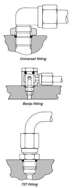

FIG. 1. TWO COMMONLY USED ANGLE FITTINGS are the universal fitting and the banjo type. Both may be turned to any angular position and then locked. A disadvantage of both fittings is that the O-ring can be incorrectly placed during installation, damaging it and causing a leak. The 727 fitting is the simplest of the three. It has only one O-ring which is placed on the fitting before installation. Another advantage is that the angled tube is easier to remove from the fitting.

Plumbing Improvements — Equipment studies showed the need for considerable improvement in tubing fittings, hose materials, and static and dynamic seals. Improved pump life and reliability were also desirable. Leaks at tubing fittings were attacked in two ways. First, universal type fittings, using locknuts and O-rings, and banjo fittings were eliminated. Instead unions and tube bends and angled fittings on flex lines are used, Figure 1. Second, the 727 has about 20% fewer tube assemblies than normally used on a system of this size. Tube assemblies were eliminated by grouping components into modular assemblies, Figure 2. All components are cartridges, which are assembled into the modular housing. Any cartridge can be removed without removing the modular assembly from the airplane. Also, this largely eliminates disassembly of tubing joints. A study of fabrication and tooling used on previous aircraft resulted in closer control, better tooling for the manufacture and installation of tubing, and tighter control of material for tube assembly components.

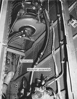

System A is the utility system which operates the landing gear retraction system, nose gear steering and brakes, leading edge slats and flaps, trailing edge flaps, ground spoilers, and half of the flight spoilers. In addition, it provides one of the hydraulic power sources for the ailerons, rudder and elevators. Two engine-driven pumps installed on accessory pads of the number one and number two engines supply hydraulic power. The reservoir is pressurized to 45 psi by engine bleed air routed through a combination pressure regulator/relief valve. Case drain cooling fluid from the two engine-driven pumps is brought together and routed through a fluid-to-fuel heat exchanger in the right fuel tank, then returned to the reservoir through the return system filter.
RESERVOIR OF SYSTEM A and packaged components are readily accessible from the aft passenger stairs.
