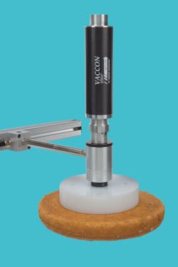

To accommodate the physical characteristics of the product, Vaccon developed a 6-in. diameter rigid cup composed of ultrahigh-molecular-weight polyethylene with mesh screening. The screening creates a greater surface area for suction, generating a vacuum head able to spread the vacuum tension over the entire top surface area of the cake without marring or dimpling.
A continuous vacuum flow is delivered by Vaccon CDF 750H adjustable air amplifiers with solenoid valves added for instant on-off control for pick-up and release. This is not a hard vacuum that must be released, but continuous flow and pressure controlled via solenoid valves.
The Vaccon-developed vacuum head and air amplifiers are mounted on an arm that moves the cakes from the end of the production line over the shipping carton and lowers them into the carton. The same process is applied to the slip sheets between the cakes.
