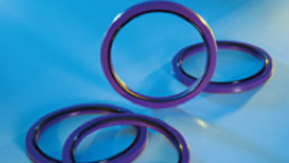

New materials such as NOK UH05 urethane let seals handle extreme temperatures and pressures, as well as nonstandard hydraulic fluids.

To meet future high and low-temperature requirements, Simrit recently developed NOK UH05. This urethane matches Disogrin 9250’s cold-temperature performance at -40° C while increasing long-life high-temperature system capability to an industry leading 120° C. The trade-off is that UH05 is more difficult to process and, therefore, best suited for thinner cross-section buffer seals. It’s currently in production for select cylinders.

Sealing systems such as Simrit’s IUY combine urethanes and elastomers and work well in extreme conditions. Note that JIS-standard groove sizes will hold a back-up ring independent of the rod seal. North American and DIN standard seal grooves do not. Designs that combine the backup ring with the seal overcome this problem.

While the JIS standard allows for a back-up ring independent of the rod seal, North American and DIN standard grooves often do not. This creates an issue with the retrofit of new sealing systems into existing cylinder grooves. To address this challenge, Simrit developed a design that integrates the back up into the seal.
Called the IUY rod seal, it is incorporated into a system using the UH05 urethane buffer, G928 HNBR rod seal, and Disogrin 9250 urethane wiper. It was on/off cycle tested at 110° C and 120° C for 500 km (0.4 m/sec) at 32 MPa (4650 psi) for comparison against a U641 rod seal and buffer. Residual interference results show the systems did not leak at either temperature, but the effects of compression set are apparent in the urethane seal, especially at 120° C. The HNBR G928 rod seal demonstrated significantly higher residual inter ference i n both cases. These results directly correlate to longer system life.
