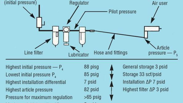

Point of use
The point of use is the logical place to begin developing a profile of the standards that will be used in the design. As demand volume is a function of supply pressure, it is important to control the pressure at the point where the air is used.
The differential established between the highest pressure at which air is removed from the system and the lowest supply pressure is called general storage, or stored energy in the overhead piping system and receiver. Properly maintained, general storage prevents one air user from interfering with another.
An important criterion for the design of the point-of-use standards is the differential of the installed components. All components have a resistance to flow — this resistance is called pressure drop, or ∆P. Pressure drop can be inconsequential or devastating to a system, often depending upon the original equipment suppliers. Pressure drop cannot be ignored, because a corresponding amount of supply energy will have to compensate for it.
Unlike electricity, where installation components can be matched to the amperage and voltage of the user, little thought is usually given to the proper selection of compressed air point-of-use components. Hose, fittings, disconnects, filters, and regulators are all rather standard fare for the user. Lubricators, check valves, dedicated storage, and metering valves may also be required.
Figure 1. Typical point-of-use area of a compressed air system. Click on image for larger view.
Selection criteria should be based on the differential pressure generated at the highest flow and lowest supply pressure. Selection should be made one component at a time backwards from the article pressure, which is the pressure required at the inlet to the pneumatic device. A maximum allowable differential should be established for application between the lowest initial pressure, P4, and the highest article pressure in the system, P5.
Often, these components such as miniaturized or interlock filters, regulators, and lubricators are selected based on ease of installation. Hose, tube, and fittings are too often chosen for ergonomic, spatial, or appearance issues. If the consequences of differential are not considered, the system may have to operate at a much higher pressure to compensate. The financial consequences of uninformed installation decisions could result in a six-figure utility operating penalty.
One note about the regulator — the differential appears on the upstream side. If there is a 10 psig differential at rated flow and pressure across the regulator, and the desired setting of the regulator is 80 psig, the regulator will need to be supplied 90 psig. If the supply drops from 90 psig to 89 psig, the regulator will drop from 80 psig to 79 psig. This is called tracking supply.
Of the components at the point of use, the regulator is the most sensitive to differential. This problem is compounded with miniature regulators. There are many systems that must operate at 30 psig higher pressure because of a miniature regulator on an application.
