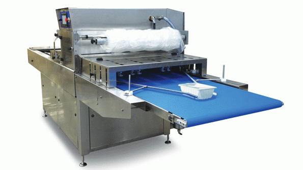

The Rhino 12 modified-atmosphere packing machine controls the gas inside a food package to preserve freshness and extend shelf life.

One of the latest offerings from UltraSource, Kansas City, Mo., is the Rhino 12 high-capacity modified-atmosphere tray-packing machine that’s specifically built for washdown environments. It’s designed for medium to large-sized commercial production and accommodates bowls, trays, and family packs. For example, the Rhino 12’s extra-wide seal area simultaneously handles up to four rows of popular #3-sized trays.
Machine throughput rates are up to:
  •  7 cycles/min for vacuum/gas mode.
  • 8.5 cycles/min for gas-flush mode.
  • 10 cycles/min for seal-only mode.
A stepper motor advances trays with ±0.5-mm repeatability into the sealing mold, where they’re sealed with plastic film and then automatically discharged. But because the unit must stand up to the heat, chemicals, and high pressures common to washdown environments, much of the motion control and actuation depends on pneumatics.

Other features of the Rhino 12 include a controlled film-advance system that reduces film breakage to near zero and tightly controls advance distance from the uncut side for optimum conservation of film. Its proprietary film-clamping system provides assured sealing. And a pivoting discharge conveyor provides for easier maintenance access to the inside of the sealing area than most if not all high-capacity tray packers. Product changeovers take less than 15 min, as users need to change only a single tool.
The Rhino 12 includes an 8.3-cfm, 10-hp compressor, and a 7.5-hp vacuum pump. Optional features include a motorized ejection conveyor, printed film registration, integrated film labeler, 10-hp vacuum pump, and additional lane configurations.
