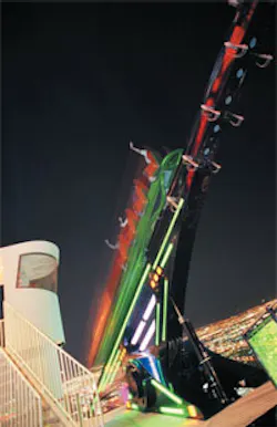

With its main hydraulic cylinder extended, X-Scream plunges riders over the edge of the Stratosphere Tower, where they are hurled toward the ground, nearly 1000 ft below.

Designed and built by Interactive Rides, Logan, Utah, the X-Scream works much like a giant teeter-totter. Bobby Ray Harris, senior vice president of operations at the Stratosphere, explains that an 80-ft long beam pivots at a central point to cause one end of the beam to rise while the other end lowers. Eight passengers get strapped into a car that rolls on a 78-ft track attached to the beam. Once seated, passengers find themselves tilted backward slightly at a 10° angle, looking out at a distant horizon.
Waiting for airlift by helicopter are bundles of accumulators, foreground, that will be moved to the top of the stratosphere Tower. Behind them is the motion base with the pair of hydraulic cylinders visible at either end of the pivot point.
When the ride begins, explains Clay Slade, president of Interactive Rides, a pair of hydraulic cylinders actuate to pivot the inward end of the beam upward by as much as 45°. The outward end, which extends beyond the outer edge of the Stratosphere Tower, pivots downward. With nothing to hold the car back, gravity pulls the car forward, so it rolls down the track and beyond the top surface of the Stratosphere tower.
Harris says that as the car descends beyond a certain point, riders cannot see the track beneath them — only the ground, 866 ft below. In fact, the wheels of the car are situated toward the back, so riders seated in the front of the car may actually feel as if they’ve traveled beyond the end of the beam.
Another terrifying aspect of the ride, continues Harris, is that the pivot point lies near the edge of the Stratosphere Tower. The car travels at 30 mph and is still accelerating when it passes beyond the edge of the Tower. When the car reaches the end of its travel, it is below and nearly 30 ft beyond the edge of the tower and tilted toward the ground.
So what keeps the car from rolling off the end of the beam and plunging nearly 900 ft below? Slade says a series of permanent magnets embedded in the beam brings the car to a controlled stop every time. Because the magnets produce magnetic fields at all times to stop the car, operation is 100% reliable even if all electrical power is lost. Furthermore, stopping is consistent under a wide range of weather conditions. And because stopping does not involve contact between parts, wear — and its associated maintenance — does not occur.
As if this isn’t enough, XScream delves out even more terror. Once the car reaches the end of its travel, the hydraulic cylinder retracts, hurling the beam skyward. This causes the car to roll backward, so the whole process can repeat. This process continues, seemingly at random, for a ride cycle of about one minute. Slade says the control computer contains more than 100 different ride programs, so no two consecutive rides are identical. And for those who dare, the ride program can pivot the beam so that the car plunges downward at 1 G acceleration, giving riders the feeling of weightlessness.
