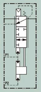

A dual input valve uses two independent pilot ports to control modulated air braking pressure. The dual design functions the same as a single design when pilot pressure is applied to either the P1 or P2 port. When pilot pressure is applied to P1 and P2 ports at the same time, controlled air braking pressure ratio increases proportionally. The P1 and P2 ports can be of different pressure ratios.

The tandem input valve functions the same as the single design except it provides redundancy by having two independent pilot pressure ports. Hydraulic pilot pressure can be applied to the P1 and/or P2 port, and the pressure ratio remains the same.
