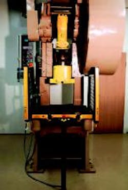

An example of such a press control is the Command Stamp unit shown. Installed on a 1960s vintage 80-ton Minster Press, the control system was developed by Reflex Integration, a joint venture company of Penmar Automation and Soft Design Automation. This unit has been third-party verified to meet the CSA Z142-02 standard, which became mandatory this year.
