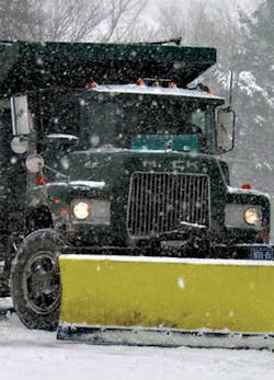

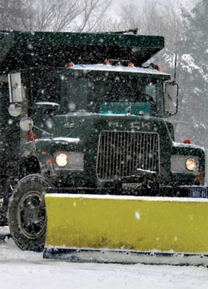

A large snow plow truck was brought to Turner Hydraulics in Carlisle, Pa., the day after a snow storm dumped several inches of snow on the east coast. The operator complained about the pump pressure line failing and noted that it would be fine if he only ran the salt spreader circuit. However, if he moved any of the plow circuit cylinders to a bottomed-out position, the pressure hose from the pump would fail. None of the other hoses on the truck circuit had failed; the pump pressure hose was the only one that did. He tried to prevent any cylinder that he moved from bottoming out, but he could not always judge its position correctly and, consequently, would cause another hose to fail.
