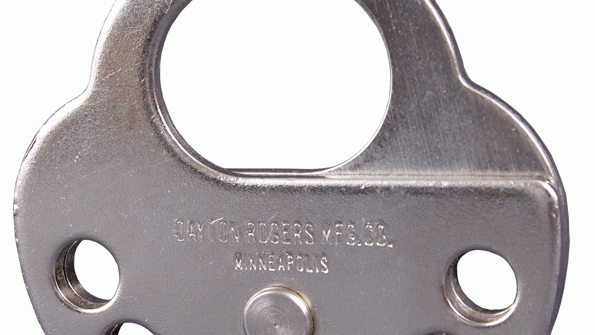

Figure 2. A lockout-tagout hasp lets technicians isolate several power sources before working on a machine.
Manufacturers often use electrical safety systems to stop equipment by installing interlocks on doors or simply hitting the E-stop button. Using a single lockout point that is required to gain access helps ensure that all energy sources are accounted for and the machine is in a safe state.
Placing this lockout at a convenient and typical entry point on a large piece of machinery quickly allows for safe operator access. This eliminates the time that otherwise would be needed to work one’s way in and around a machine to find and disable multiple lockouts (Fig. 2). SPLO offers safety and productivity in a single package, and manufacturers can calculate the return on investment based on the lockout time savings.
