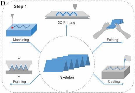

The actuators leverage a spring, origami fold, or solid skeleton structure with hinged or elastic voids to achieve motion under negative pressure. Thin sheets of thermoplastic polyurethane (TPU), vinyl (PVC), polyester, and a TPU-coated nylon fabric make p the actuator skin to cover the skeleton. The skeleton is constructed using methods including 3D printing, machining, casting, forming, and manual folding. Methods like heat-pressing, gluing, welding, zippering, and sewing were used to seal the skin.
Using a symmetrical zigzag geometry, the team could achieve a 90% linear contraction. To see this actuator in a miniaturized form, and in a larger form lifting a 20-kg load, view this movie included in the report. The image below shows examples of actuation using zigzag configurations under negative pressures. To learn more about programmable motions with advanced folds, and the performance capabilities of spring actuated actuators compared to folded designs and skeletons with hinges, see videos, images, and details listed in the report.
