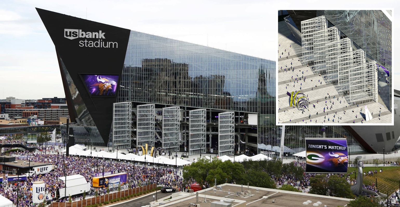

When the 2017 NFL season begins, Minnesota Vikings fans will enter the $975 million U.S. Bank Stadium through the five largest pivoting glass doors in the world. The stadium’s entryway is considered one of the most impressive kinetic structures of its kind.  Each door is opened and closed by three pairs of  8-in. bore hydraulic cylinders. They stand 75- to 95-ft. tall, are 55 ft. wide, and weigh 57,000 lb. each. Aesthetically, the structure provides fans with an “open-air” experience even from inside the stadium.
U. S. Bank Stadium uses 15 pairs of hydraulic cylinders to open and close the five largest pivoting glass doors in the world. The hydraulic system safely and reliably actuates the doors and has been designed to blend in with the building’s architecture, providing fans with an “open-air” experience from inside the stadium. (Photo courtesy of Associated Press)
