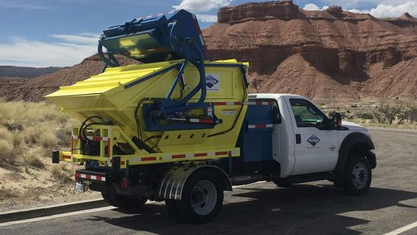

Designed and manufactured by Perkins Mfg. Corp., Bolingbrook, Ill., the S6-WSK consists of a 6-yd3 dumpster that fits into a standard pickup truck bed. The dumpster has two doors that can be opened and closed by hydraulic cylinders.
This isolated view shows the workings of the S6-WSK, including some of the hydraulic cylinders that lift the doors and the bucket assembly.
However, the business part of the S6-WSK is its shovel. The shovel is actuated by a pair of hydraulic cylinders and mechanical linkages that move it to ground level for easy loading of the animal. The shovel can lift loads weighing up to 1,200 lb. from a hydraulic working pressure of 2,100 psi. The hydraulic power unit is sized to provide a 16-sec cycle time—fast enough for quick operation at a safe speed.
Designed by Carlos Arrez, of Perkins, the S6-WSK comes with manually operated hydraulic directional valves mounted at the rear of the unit. An operator can open and close either of two doors on the dumpster from this valve station. After opening a door, the operator actuates a valve to raise the shovel, which pivots 50 deg. to drop animal into the dumpster. Once the operator closes the doors, the hydraulic cylinders ensure that they stay closed.
