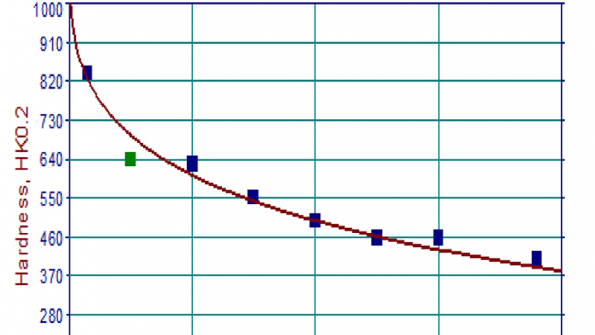

Figure 1B. Hardness profile on cross section of the sample.Note the dark oxide layer and the compound layer below it.

Chromium plating can produce a monolithic layer on top of the steel component as shown in Figure 1A. The layer has significant hardness in the range of 800-900 HK (65-70 HRC equivalent) and it is plated over a comparatively soft steel base, Figure 1B. As it can be noticed, gradient of the hardness is very sharp at the surface and this may not be a very preferred stress profile in many applications. To the contrary, a compound layer present in the nitrocarburized layer (Figures 2A and 2B) is supported by the diffusion zone, which exhibits a smooth transition of the hardness.
Figure 2B. Hardness profile on cross section of the sample (b). Note normalized structure of the steel.
Unlike a chromium layer, the compound zone is not a coating. Instead, it is formed by diffusion of nitrogen and carbon in the steel. Therefore, there it readily adheres to the steel substrate. It has been proven that the chromium-plated layer has micro-cracks, and because of that, flaking might occur if the direction of sliding is not perpendicular to the crack7, 8.
