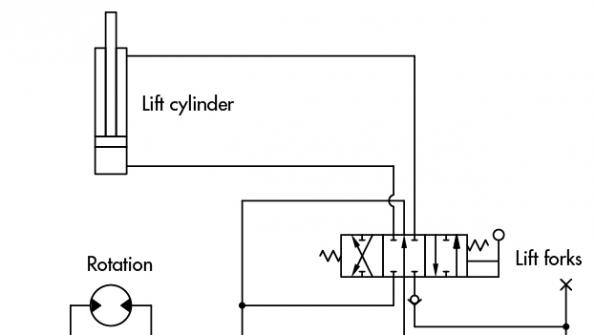

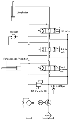

A lumber company had an older yard stacker machine that they wanted to put back into service. The problem: The boom lift cylinder would drop when the operator also rotated the forks at the same time.
A lumber company had an older yard stacker machine that they wanted to put back into service. It had been out of service and parked due to a problem with its boom sometimes dropping. The boom lift cylinder would drop when the operator also rotated the forks at the same time to align the 4×8 and 4×12 sheets of plywood and plasterboard when placing them on top of other stacks.
I looked at the problem and noticed the operators would lift and rotate at the same time when the problem happened. If they only ran one function, the problem would not occur. All the other trucks worked well running both at the same time and expedited the unloading of the supply trucks. I told them they could use the truck but not to rotate while they were lifting. This sounds well and good, but the operators were accustomed to using the other trucks, so the operators sometimes ran lift and rotation at the same time out of habit. As a result, the problem still occurred.
The circuit shown seems to be how the hydraulic system was designed. Any idea about how to solve the problem?
