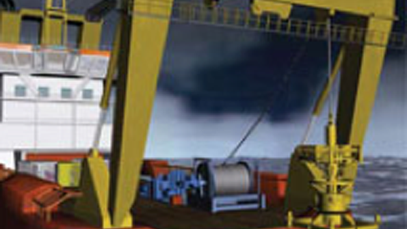

The AHC system makes the raising, lowering, and handling of loads on floating vessels much safer and easier. The wire carrying the load is routed from the towing winch through the AHC system to actively compensate — or in effect cancel out — the ship’s movements in the pitch and swell of the open sea.
The AHC System combines hydraulic, pneumatic, and electric power and control component, integrated into the following units:
• Heave Compensator Unit (HCU), containing the hydraulic cylinder assembly, along with special front and aft wire guides called sheaves, and located in a dedicated, containerized housing that can be easily positioned on aft decks, • Air Vessel Unit (AVU), a completely outfitted air pressure vessel unit, optional in a housing, • E-H-P Power Pack is the containerized electric, hydraulic, and pneumatic power generation and control, and • Operator Control Panel (OCP) contains the controls and condition readouts to operate and monitor the AHC system.
All of the major components are housed in hardened, weatherproof containers for efficient placement and integration with existing aft deck winch systems. Secure hatch covers isolate equipment from air and water penetration during non-operating conditions. An effective AHC increases the safety of the ship, the cargo, and the crew — and significantly reduces the risk of damage to components intended for placement on the seabed.
Compensator operation
To operate, a load (such as an undersea pipe) is suspended by steel wire rope. The wire rope unthreads from the ship winch, and then runs through two sheaves attached to the HCU rod, which is attached to the hydraulic cylinder assembly. The wire and load are then “reeved” over an overboard sheave unit into the water.
To control the operation, the AHC cylinder contains both an active and passive part. A passive heave compensation compartment suspends the static load — the pipes being lowered. This passive system is pneumatically powered and acts as a spring with a low spring coefficient. This essentially “zeroes out” the load at the end of the wire rope.
A Motion Reference Unit (MRU) measures the movements of the vessel in pitch, roll, and heave directions. The control system uses the output of the MRU to calculate the required ACH cylinder movement and controls the cylinder to follow the desired movement as accurately as possible. The sheave assembly attached to the AHC cylinder moves back and forth, counteracting the movements the ship is experiencing. This results in a nearly steady position of the lift point (at the location of the overboard sheave) and thus a nearly steady load with respect to the fixed world.
