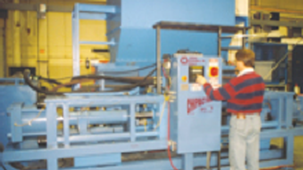

Several machines are on the market to compress metal fragments into pellets. The metal is fed into a chamber and compressed into a pellet. The problem is, most machines are single-acting. After a pellet has been made and ejected, the machine must be retracted so that the compression chamber can accept the next load of metal.
A more productive and efficient process is offered by the Model CP3 compactor, which uses a double-rod cylinder to make a pellet each time the cylinder’s piston rod extends and each time it retracts. Each pellet is compressed to about 16 its original volume. Compared to a conventional compactor, the CP3 can compact twice the amount of metal per hour while using the same amount of power. (The double-acting feature for this application is protected under US Patent 55245334.) Not only that, but the CP3 can compress different materials in its two chambers at the same time, so versatility is an added benefit.
Operation at a glance
The CP3 is controlled by a PLC, which monitors pressure and position switches and transducers to execute commands in the proper sequence with respect to time. A key component to the machine’s high throughput is its double-acting, double rod end cylinder. As one rod is extending, it compresses metal fragments. At the same time, the rod at the other end of the cylinder is retracting, opening the compression chamber for the next work cycle.
Once the rod at either end of the cylinder has retracted far enough to open the compression chamber, the PLC commands a motor to drive the respective infeed auger. After a predetermined time period, the PLC commands the auger infeed motor off and commands hydraulic valves to initiate piston rod extension.
Powered by a pair of fixed-displacement vane pumps, the piston rod extends rapidly until the metal fragments are compressed enough to cause hydraulic pressure to reach 500 psi. Once this occurs, one of the vane pumps further compresses the pellet until hydraulic pressure reaches 1200 psi.
Next, the PLC issues a command to lock the piston rod in place and then extend the rod of a die cylinder. (Once this occurs, material can be loaded into the compression chamber on the opposite side of the main cylinder.) The rod of the die cylinder directly opposes the locked rod of the main cylinder and compresses the pellet until a final hydraulic pressure is reached — up to 3500 psi.
A linear displacement transducer in the die cylinder allows the PLC to measure and record the final thickness of the pellet. After ejecting the finished pellet, the main cylinder’s rod is unlocked so it can open the chamber for the next load while simultaneously beginning the compression cycle of a new pellet on the other end of the cylinder.
