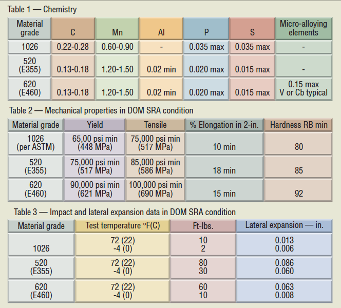

Chemical, mechanical, and impact properties of these three grades are shown in Tables 1, 2, and 3. The primary difference between the E355 and E460 grades is an addition of a micro-alloying element (up to 0.015% Vanadium or Columbium). These grades are generally available as drawn-over-mandrel (DOM) tubing, and to a lesser extent, cold-drawn seamless tubing. They are used in the manufacture of hydraulic and pneumatic cylinders, including single-and double-acting, ram, and telescopic cylinders with square head, bolted, and non-bolted construction.
Tables 1, 2, and 3. Click on image for larger view.

Because E355 and E460 materials have a lower carbon content than 1026, they possess higher weldability while maintaining similar mechanical properties to 1026 grade. The comparisons were done in studies performed at the Edison Welding Institute, Mechanical Testing of Weld Joints in Hydraulic Cylinders. This study looked at the welding of 1026, TuffDOM 520 (E355) and TuffDOM 620 (E460) tubular samples and included Charpy V-notch impact and Crack Tip Opening Displacement (CTOD) tests to compare the relative performance of the TuffDOM grades to the existing industry standard 1026 grade (see tables).
