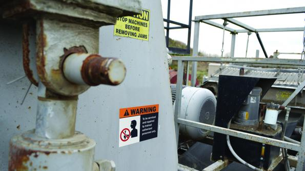

McLaren suggests specific examples of effective hydraulic maintenance labeling:
- Safety warnings could be made for specific, limited situations. Many companies leave themselves susceptible to substantial jury awards because they ignore something as simple as a warning decal. This is typically referred to as “failure to warn.”
- Critical operating parameters should be posted on every hydraulic system.
- Post normal operating parameters on all machinery; therefore, operators can detect abnormal variations during the machine’s operation.
- Information such as operating temperatures, temperature drops across heat exchangers, pump and motor case pressures, pump inlet restriction, operating pressures, pump flows, hydraulic motor displacement, and accumulator pre-charge pressures should be posted in a way that’s easily accessible for mechanics.
Spelling out every-day working hazards aids both trained and untrained workers. McLaren likes to see signs that say:
- “To be serviced and repaired by trained authorized personnel only.”
- “Do not crack connectors to de-energize a hydraulic system. Discharging hydraulic oil to atmosphere can lead to severe injury, severe eye injury or blindness, substantial property damage, or death.”
- “Disconnect the battery and de-energize the hydraulic system before performing services, adjustments, or repairs.”
- “Do not test components by discharging oil into atmosphere. Discharging oil to atmosphere can cause severe injury, death, or substantial property damage.”
- “The hydraulic oil in this system is hot enough to cause second- and third-degree burns. Do not loosen connectors until the oil temperature is below 80°F.”
It’s counterproductive to bury important machine operating parameters in some manual no one reads, so posting machine operating parameters at the user’s fingertips is essential to communications. Manufacturers can help technicians, too, by posting normal and abnormal component leakage rates on their machines.
