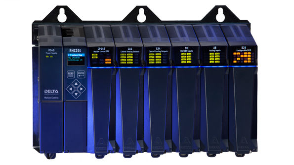

Delta Computer Systems’ new RMC200 motion controller can perform closed-loop control of up to 32 axes simultaneously.

The door to this output module used with the RMC200 opens to the right, displaying labels of the connection points. The terminal blocks (green) feature push-in wire connections with latch ejectors (orange) to reduce wiring time and simplify maintenance.
