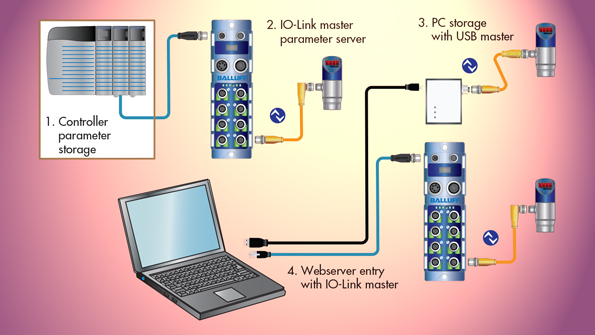

The ultimate pressure sensor would have all of the capabilities mentioned so far, as well as provide enhanced functionality and parameterization. Pressure sensors connected to factory networks through sensor-level communications protocols, such as IO-Link, can improve process flexibility and control through enhanced sensor monitoring, configuration, and error reporting back through the system controller (Fig. 10). Digital transmission of analog values over low-cost, unshielded three-wire cabling ensures high signal quality over longer distances, and eliminates signal delays and distortions that can plague analog interfaces.
10. When connected to factory networks via sensor communications protocols like IO-Link, pressure sensors can help enhance process flexibility and control.
Networkable sensors reduce downtime and configuration errors with plug-and-play functionality. Maximum system flexibility can be achieved during operation, thanks to quick and remote modification of parameters through the control system rather than at the physical sensor itself.  In addition, process diagnostics, data, and errors can be reported directly to the controller and displayed on man-machine interfaces.
