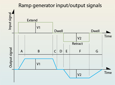

Question: What are ramp controls?
Answer: The ramp control is a special purpose signal conditioner that provides rudimentary, but effective, acceleration control. For example, imagine a machine axis powered by a hydraulic cylinder controlled by a proportional joystick. If the operator suddenly shifts the joystick to extend, retract, or stop the cylinder (the upper plot in the illustration), the axis will, with equal suddenness, accelerate — perhaps even causing damage.
The ramp control would be placed between the joystick output and the proportional valve’s input. When the ramp generator circuit receives a sudden (step) command, it does not simply amplify the signal and send it on. Instead, the output gradually rises or falls (ramps) to reach the input (the lower plot in the illustration), and, thus, gradually shifts the proportional valve to gradually accelerate the cylinder. It provides smooth starts and stops. User adjustments are available to control the ramp time on and ramp time off, and normally in both directions of hydraulic actuator motion.
