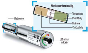

To aid in the monitoring of several key fluid parameters, Argo-Hytos, Bowling Green, Ohio, introduced its LubCos H2O+ oil condition sensor. It contains a humidity transducer combined with other sensors to determine the relative permittivity, oil conductivity, and temperature of hydraulic fluid. It can convert the key oil data accumulated at various temperatures to a reference temperature to improve comparability. It can also display signal trends in relation to time.
The different parameters can be read out through a serial interface or from a 4- to 20-mA output. In addition, the oil condition can be optically displayed to the operator directly at the machine via an integrated LED bar display. An integrated data storage unit can record data over a period of up to 6 months.
