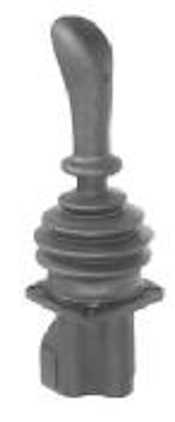

As equipment or vehicle operator cabs has become more sophisticated and ergonomic, electric joysticks have evolved even further with the adaptation of a variety of hand grips to them. Providing an operator the ability to perform multiple tasks by manipulating a variety of switches on a handgrip coupled to the input shaft of the joystick is a means of significantly increasing productivity. By using grip-mounted switches to accomplish high-frequency tasks, equipment operators no longer must avert their attention or reposition their body to activate a switch that previously was difficult to reach.
Electric joysticks are specifically designed with hollow input shafts to provide wire routing from the handgrip down through the joystick. Joysticks are manufactured as single, dual or 3-axis control ( X, Y and twist). The handgrip can provide a platform for additional proportional axes by installing a thumb wheel pot, analog rocker or thumb-operated miniature joystick.
