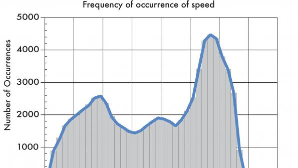

Figure 1. This prototype “what if” histogram for an HST shows the number of occurrences versus the speed in 100-rpm intervals.

The point is that regular, predictable parts — along with random variations — exist within cyclic operation. Handling these random effects requires statistical methods. For hydrostatic transmission (HSTs), the approach is to use a histogram of the “probability of finding a speed versus the speed” itself, Figure 1.

To start the explanation, one must interpret the data provided in Figure 1. It consists of a series of 35 bars, each being 100 rpm wide. The vertical axis is simply “Number of occurrences.” A total of 73,980 sampleswent into the chart. The sample counts were put into a series of 100-rpm-wide data buckets; each data bucket is a bar on the graph.
Referring to Figure 1, the height of the bar (a data bucket) with a peak value that’s centered at 2850 rpm, which covers the interval from 2800 to 2900 rpm, represents the number of samples found in that interval. That is, of the 73,980 rpm samples — about 4460 of them — lay between the 2800 and 2900 data bucket. Or, in other words, of the 73,980 speed samples, 4460 of them were in the interval from 2800 to 2900, where the notation 2900 means any tiny amount less than 2900 rpm.
To be useful, the histogram must be converted into one that indicates the “probability of occurring,” expressed as a percentage. This task simply requires dividing each bar amplitude by the total number of samples. In the 2800 to 2900 interval, with its 4460 samples, the result is 4460 ÷ 73,980, about 6.03%.
Thus, the modified histogram turns into a probability curve, Figure 2. Therefore, if the machine is operated in a statistically similar manner to that used to generate the histogram data, it will run between 2800 and 2900 rpm about 6% of the time. It will also run, say, between 900 and 1000 rpm about 3.5% of the time.
