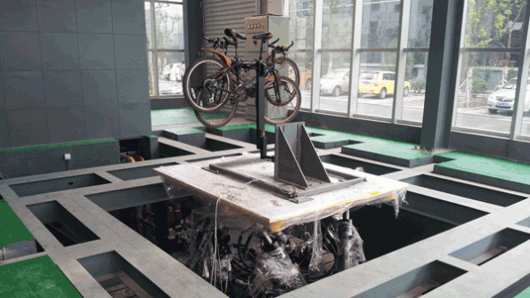

A hitch-mounted bike rack sits atop the newly delivered Moog 6 DOF Hydraulic Simulation machine, still wrapped in packing material, inside the Kemflo R

Kemflo uses its new hydraulic simulation table to mirror the different road conditions that its car racks encounter. It’s a complex undertaking to control each individual degree of motion because a movement along one axis involves using all of the simulation table’s six actuators. Kemflo engineers control all the actuators in terms of timing and speed, even as the table vibrates from 0 to 100 Hz.
To “road” test its products, Kemflo attaches the roof of a car (carrying a Kemflo car rack) on top of the simulation table. By simulating road conditions with proving ground data, the table precisely recreates the durability feedback Kemflo would gain from actually driving a vehicle. Engineers and designers use the table for virtually any test type or method on any Kemflo accessory.
