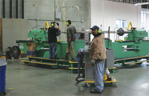

Figure 1. LMI Aerospace's stretch forming machine has two arms that are hydraulically operated to wrap the aluminum part to be formed around a die. The operator station is in the foreground.
When LMI Aerospace Inc., St. Charles, Mo., wanted to bump up productivity on its machinery, it turned to electrohydraulic motion controllers to get the job done.
The provider of structural components, and assemblies to the aerospace, defense and technology industries wanted to increase productivity by updating the technology of an old hydraulic stretch forming machine, Figure 1, that makes aircraft parts, such as fuselage frames, wing skins, winglets, and nacelles. Built in the 1960s, the machine differed little from stretch forming machines that were first developed in the 1940s during World War II. The machine wraps a part such as an aircraft frame component around a die and pulls it to conform its shape to that of the die. When it was new, the machine had a very rudimentary open-loop hydraulic control system incorporating manual “bang-bang” valve controls. The operators had to bump switches on the control panel, which activated valve solenoids to move the stretch arms. Therefore, even when the machine was new, control of the stretching process wasn’t very precise.

The motion controller needed to control four hydraulic axes simultaneously: two hydraulic cylinders that power the swing axes (under position control only) and two cylinders that power the tension axes (controlling both position and pressure). The swing axes extend around the die in a big arc, with the part to be formed held at each end by jaws attached to a tension cylinder that clamps it to one of the arms, Figure 2. While the swing arms are wrapping the part around the die, they need to maintain precise tension on it. Depending on the shape of the die and the geometry of the arms, the tension cylinders need to extend as the part is formed to avoid over-tensioning the part.
