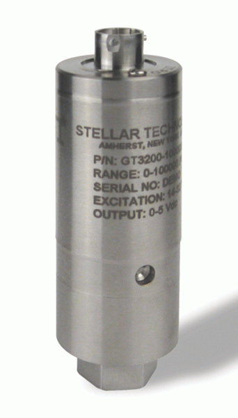

High-pressure transducer
Series GT320 and GT32XX pressure transducers use a sensor with electronics to provide high pressure and fatigue ratings with accuracy of 0.25%, and upgraded accuracy of 0.1%.
Series GT320 and GT32XX pressure transducers incorporate a proprietary sensor design with electronics to provide high pressure and fatigue ratings with accuracy of 0.25%, and upgraded accuracy of 0.1%. With pressure ranges from 20,000 to 100,000 psi, they are ideal for high cycle and ultra-high pressure applications. GT320 offers mV/V output and GT32XX provides high level current or voltage output, as well as digital output including CANbus, RS232 and RS485.
Both have been designed to accommodate user-specified process connections for pressure and electrical terminations. They feature all-welded stainless steel construction, are shock and vibration protected, and have a zero adjustment pot as a standard feature.
