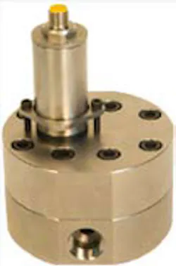

G-series precision gear flow meters operate at maximum flow rates of 45 and 105 lpm, respectively, with 0.3% reading accuracy across a 100:1 flow range. They are calibrated with 30 cP fluid, but are compatible with fluid viscosities from under 5 ...
Feb. 15, 2008
G-series precision gear flow meters operate at maximum flow rates of 45 and 105 lpm, respectively, with 0.3% reading accuracy across a 100:1 flow range. They are calibrated with 30 cP fluid, but are compatible with fluid viscosities from under 5 to more than 100,000 cP. Stainless steel bodies operate at pressures to 6000 psi. Gear design minimizes pressure drop and eliminates high flow rate cavitation.
