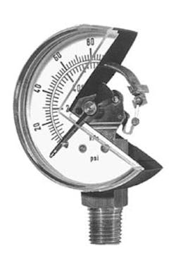

Figure 1. Cut-away view of C-shaped Bourdon-tube pressure gauge. Pressure induced strain in the Bourdon tube causes it to deform. Transmitting this deformation to a pointer through a movement linkage provides a visual indication of pressure.
The majority of gauges for measuring pressure have one common characteristic: pressure being measured is the only source of energy required to provide visual indication of static pressure. Some form of elastic chamber in the gauge case converts pressure to motion, and is translated through links, levers, and gearing into movement of a pointer across an indicating scale. Three types of elastic chambers are used in fluid power system gauges:
  • C-shaped, spiral, and helical Bourdon tubes, Figure 1
  • bellows, and
  • single- and multi-capsule stacks.
