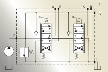

Figure 1. Conventional ISO schematic representation of the parallel configured, opencenter, two-function, directional control valve.

The conventional ISO schematic representation of the parallel configured, open-center, 4-way directional control valve is shown in Figure 1. This and the two previous configurations require transition check valves. They prevent a gravity-loaded cylinder from inadvertently descending when its function is shifted such a small amount that supply pressure has not yet built up enough to hold the load. Previous editions of “Motion Control” further explain these important check valves.
The term “parallel” is derived from the fact that each 4-way spool (function) receives pump flow through a galley in the stack, labelled PB in Figure 1. Thus, all the spools are in parallel. This also means that no recovery of spent flow occurs either through the bypass path or the return flow from shifted upstream 4-way functions. Recall that flow recovery was possible in the full series and partial series and could cause quite complex interactions between loads during simultaneous spool shifts.

Interactions between functions definitely occur in the parallel configuration. Figure 2 is a simplified analytical schematic showing the active lands when both active 4-way spools are shifted to extend each respective load cylinder. Suppose, for example, that relatively well-balanced loads are on each of two functions to be shifted. If one function is fully shifted while the other is centered, the operated cylinder will extend at a speed determined by its piston area and the pump output flow. If the other function is also shifted, it will “steal” flow from the first function, causing the first function to slow down.
Figure 4. This cutaway of the parallel configured valve stack helps to clarify some of the construction details.
On the other hand, suppose a considerable disparity exists between the loads of two functions, and further suppose that the more heavily loaded function is shifted first by some arbitrary amount. If the lightly loaded function is also shifted, pump pressure will drop because of a lower resistance path in the lightly loaded function. Plus, the heavily loaded cylinder will slow down, and in the extreme case, it will actually stop.
