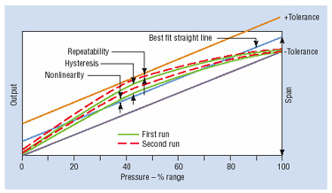

Many other characteristics — such as linearity, hysteresis, repeatability, etc. — help to determine the measurement accuracy of a pressure transducer, Figure 1. Additional factors, equally important, are more elusive. These include packaging, configuration, construction materials, and internal design. Each of these can be appraised on the basis of field testing and/or experience.
Overall, the best pressure transducer for one application is not necessarily the best for another. In fact, a transducer with the second best performance may be the best choice for an application if its price is significantly lower.
Figure 1: Components of static accuracy: non linearity, hysteresis, repeatability.
