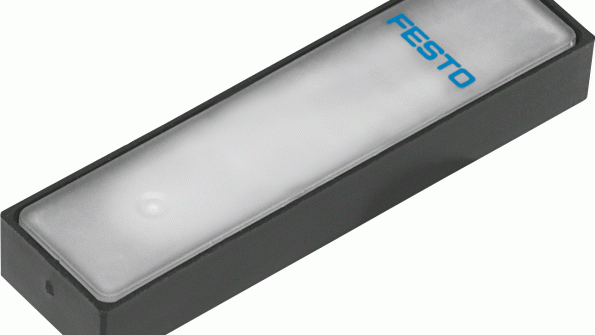

Festo’s VEMC 3/3-way valve measures only about ¼-in. high by ½-in. wide.

One version, its VEMR 2/2-way valve, measures 1.7 × 0.4 × 0.5 in. and is rated for 17 lpm flow at 30 psi and inlet operating pressures from 10 to 50 psig. Response time is <10 msec, leakage is <0.6 l/hr, and it is compatible with air, oxygen, and inert gases. The valve is suited for flow control, but combining it with a flow sensor makes it a proportional flow-control valve.
The company’s VEMC 3/3-way valve has rated flow of 11.0 lpm (at 14 psi) on the connection side and 9.5 lpm (at 14 psi) on the exhaust side. It’s designed for pressure regulation, and adding a pressure sensor makes it a proportional pressure regulator.
