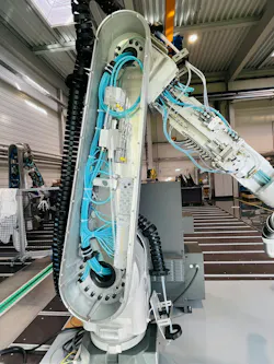

Pre-Engineered Systems Simplify Design Work for OEMs
Some suppliers offer the advanced pressure regulator and flow sensors as part of a pre-engineered, pre-programmed panel. In addition to these components, the compact panel also includes a proportional valve for atomizer control and lightweight valve terminal with AES I/O.
All components are attached to a metal plate that machine builders can install inside a robotic arm and simply plug in pneumatic tubing and electrical connections.
An integrable dew point measurement system also makes it possible to monitor the painting process in real time and take action as soon as the pressure dew point temperature of the spray air falls outside the recommended range of > -30 CTD. This can prevent further scrap and production delays before they occur.

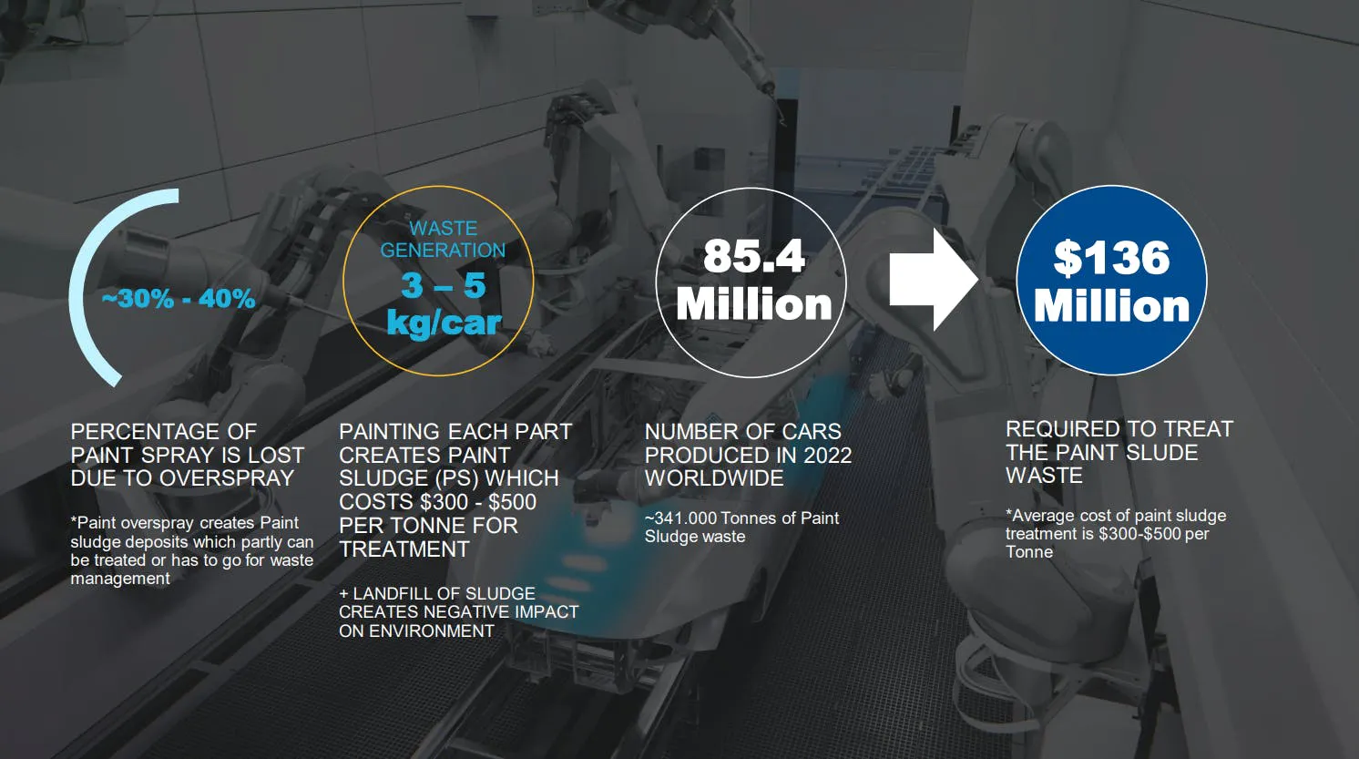

Understanding the High Cost of Overspray
The media sprayed during automated paint processes is more than just paint. It’s also compressed air, otherwise known as shape air. These two elements combine inside a robotic sprayer arm that then releases the mixed media stream.
Overspray occurs when some paint particles are blown into the air rather than onto the surface of the vehicle. And it’s estimated to cost automotive manufacturers well over $100 million a year worldwide.
The costs add up in two primary ways: excess material cost and waste treatment.
Consider first material cost. High-end cars, for instance, require three to four coats of paint, which can total up to $7,600 per car. If 30-40% of paint becomes waste due to overspray, that’s $2,280-3,040 in media waste per car.
Then, add in waste treatment. Overspray results in about 3-5 kilograms (kg) of PS per car. PS cannot be landfilled, which means that factories must treat it before disposal. This incurs extra labor and process costs that can range in amount depending on region. In the United States, for example, it’s typically $300-500 per ton.
There were 96.4 million cars produced globally in 2025. If painting each of these automobiles results in 3-5 kg of PS, then paint processes generated approximately 341,000 tons of PS. If it costs $300-500 per ton on average to treat paint sludge for disposal, then the worldwide total for 2025 can be estimated at about $136 million.
Added to the cost of media waste, it’s easy to see that minimizing overspray presents a great cost savings opportunity for automotive manufacturers.
