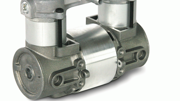

The 2220 Series compressor from the Thomas Div., a Gardner Denver Co., Sheboygan, Wis., is designed for medical and other applications requiring a compact, lightweight compressor with variable output. The 2220 is a brushless-dc, oilless design that’s small (3.77-in. high × 2.64-in.wide × 4.70-in. long) and weighs only 1.48 lb (0.7 kg).
The 2220 Series compressor runs at an ambient noise level of only 45 dBA.
The compressor has an efficient variable-speed motor that produces flow to 1.1 cfm (32.3 lpm) and pressure to 30 psi (2.1 bar). The 2220 includes permanently lubricated bearings, stainless-steel valves, and wetted parts that are treated for corrosion resistance, all of which contribute to long life. The design takes advantage of Thomas Wob-L piston technology that’s balanced for low-vibration operation, combined with an enclosed crankcase to provide durable yet quiet (45 dBA) performance.
A Wob-L type compressor has a unitary piston rod that “wobbles” inside the cylinder as the crankshaft rotates. Unlike a conventional articulated-piston pump, the Wob-L has no wrist pin connecting the piston rod to the piston. Instead the piston and rod are a single component, usually a casting. The piston rod mounts to an eccentric bearing assembly, which, in turn, connects to the motor shaft and converts rotary motion from the motor into linear motion of the piston within the cylinder.
The piston is sealed to the cylinder by a flanged disk cup that forms both a seal and mechanical guide for the piston. It runs without lubrication against a low-friction, hard-coated cylinder. As the piston is driven up and down, air resistance on the upward stroke expands the disk’s seal on the piston against the cylinder wall to increase its efficiency, while compensating for the wobble action.
A key benefit is oil-free operation, which makes the Wob-L piston design well suited for use in the medical, automotive, and beverage industries. Pressure-versus-flow and vacuum-versus-flow characteristics are generally superior to those of diaphragm pumps. Wob-L-type compressors provide greater flows at any given pressure or vacuum, to ensure more-consistent, longer-life operation in a physically smaller unit. Finally, as a piston pump, an inherent characteristic of the design is that the failure mode is gradual fatigue, rather than a catastrophic failure mode that is characteristic of many other designs.
