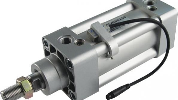

Extruded body, ISO 6431-compliant air cylinders have standard magnetic pistons in seven bore sizes from 32 to 125 mm. Stroke lengths are to 1000 mm.
Aug. 9, 2012
Extruded body, ISO 6431-compliant air cylinders have standard magnetic pistons in seven bore sizes from 32 to 125 mm. Stroke lengths are to 1000 mm. Adjustable air cushions at both ends and machined male rod threads with jam nut are also standard. The hard-anodized aluminum cylinder tube ID and OD ensures corrosion resistance and long product life, and lubrication is not required. Optional position sensor mounting brackets fit over any of four extruded housing rails.
