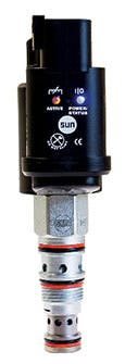

Sun Hydraulics Corp. introduced a new way to configure embedded amplifiers without using a PC or wired connections. The new version of Sun’s Embedded Amplifier series can be configured via an iOS or Android app using Bluetooth for quick, easy, reliable wireless calibration.

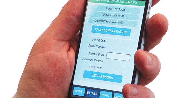

AmpSet Blue lets users locate and pair with the selected amplifier using their smart device and adjust all parameters of the proportional controller through several simple screens.  Users can name each device and save, store, recall, and share settings for future use.
The AmpSet Blue app for iOS and Android phones lets users configure proportional cartridge valves from Sun Hydraulics. The free app can be download for iOS from Apple’s App store or from Androir from sun’s website. Click on image for larger view.

Password protection prevents unauthorized access to the amplifiers. Added safety os provided by a “connection time-out” feature, which is activated by a period of non-use to prevent the user from leaving the application open and paired.
The controller is CE and RoHS compliant, sealed to IP69K, encapsulated for harsh environmental usage, and has enhanced diagnostic LEDs that give real-time operational status.
