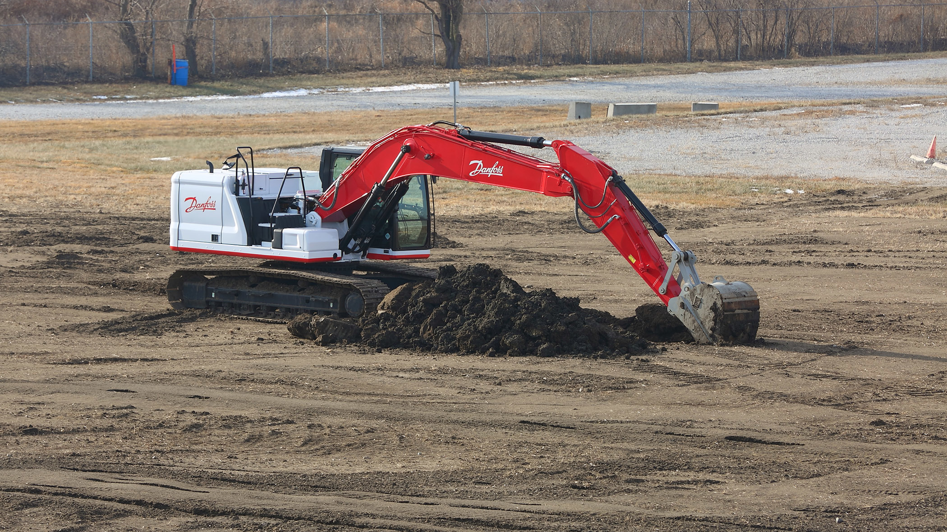

Danfoss will convert an electric excavator to use its Dextreme Max system and demonstrate how improving hydraulic systems can aid emissions reduction efforts. Note: The pictured excavator is a representation of the machine type Danfoss plans to convert, not the actual machine.

Danfoss Scotland, part of Danfoss Power Solutions, has received a grant to accelerate development of technologies which will help to decarbonize excavators. The company will use the funding to validate its Dextreme Max system in a 30-ton electric excavator, which can improve hydraulic system efficiency, leading to emissions reductions.
Danfoss plans to convert a 30-ton electric excavator to demonstrate how improving the efficiency of the machine through use of the Dextreme system and other design changes can reduce energy use and thus emissions.
