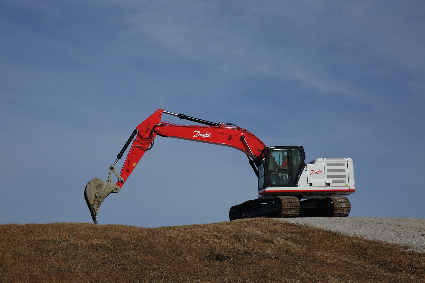

In its whitepaper, Danfoss looks at how readily available technologies can be used now to improve the energy efficiency of construction equipment and thus reduce emissions. The company says current excavator systems, for instance, operate on diesel at 30% efficiency, with 70% of engine energy being wasted.
Hydraulic systems are integral to the operation of construction equipment, but known to be inefficient. Improving the efficiency of these systems through use of technologies such as variable displacement pumps, Danfoss' Digital Displacement solution, variable speed pumps and decentralized drives, along with energy recovery systems, could greatly benefit the overall efficiency of excavators and other construction equipment.
Use of more energy efficient technologies enables machines like excavators to be equipped with smaller engines, leading to reduced fuel use and  emissions. The company states in its whitepaper that advancements in energy efficient technologies can enable fuel savings of 15-30% in excavators over 15 tons. This benefits environmental goals as well as operational costs for machine owners. As these machines are used for business purposes, highlighting the potential benefits to an end-use customer's bottom line will increase the likeliness of their purchasing more energy efficient machines which will help with their uptake in the market.
Energy efficient technologies can benefit the transition to electrification as well. The less energy machine components and systems require, the longer a battery can last between charges. According to Danfoss, use of energy efficient technologies can reduce battery capacity by up to 24.8%.
Danfoss is currently working with customers to test use of its Digital Displacement pump technology as part of the Dextreme system for excavators to see what energy savings can be achieved. The digitally controlled pump enables a high level of control and fast response times, allowing for hydraulic flow to be provided as needed which helps to improve the energy efficiency of the entire hydraulic circuit. The pump and Dextreme system can benefit both diesel and battery-powered machines.
