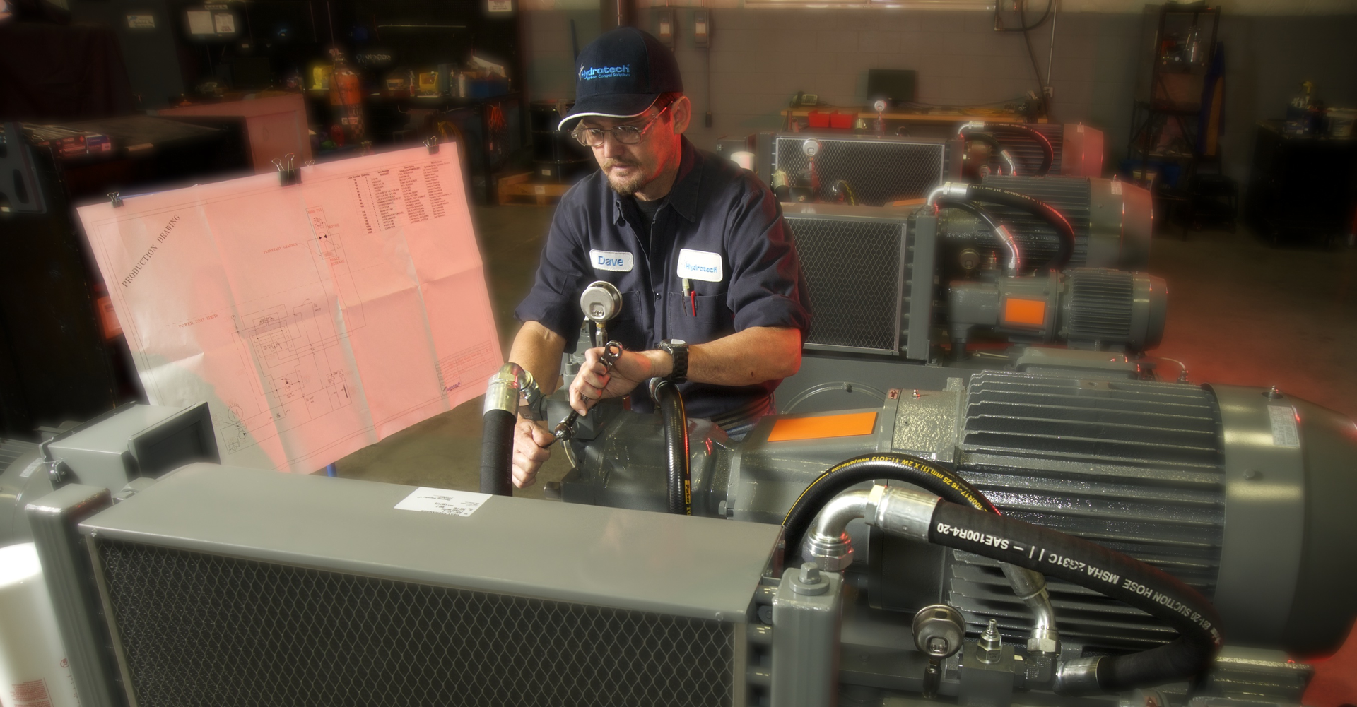

Step-by-Step Procedure
As we do with any assembly such as this, the first step in our process was to completely dismantle the HPU, so as to individually test each component to determine if any can be rebuilt and reused in the reworked unit.
Reservoir—The reservoir is internally inspected for rust, broken welds, and other damage. Any evident damage that we believe compromises the integrity of the structure is repaired. Examples of this would be rusted drip pans and baffles that have broken loose. For this set of repairs, we found that one of the internal baffles had broken loose. It was welded back in place to ensure that the return oil was turned over before moving its way to the suction side of the reservoir.
Any modifications needed are resolved before sending the reservoir out for alkaline cleaning. This might include adding additional down lines, or brackets for components to be added. Next, any rusted areas are removed (cut out) and new steel welded back in. All welds of the reservoir are tested with a non-destructive crack detection penetrant fluid.
Pump—All internal hard parts are inspected for signs of wear or damage caused by cavitation, contamination, or high case leakage. Such problems usually indicate that changes to the system design are needed. All soft parts (seals) are replaced, as are hard parts needed to complete the repair. The pump is tested separate from the rest of the power unit to ensure good working condition, as well as to ascertain that it meets factory specifications.
The pumps we originally installed on these HPUs were Rexroth 1PV2V4-2X pumps that had been phased out in the mid-’90s. The outdated electric motors were replaced with more-efficient Toshiba EQP Global motors. The obsolete Rexroth pumps were replaced with Bosch Rexroth 130-cc VPV vane pumps.
Valves—Spools and bores of both the main and pilot stages are checked for wear caused by contamination and velocity sheering. If the HPU has onboard electronics, the electronics are bench tested to verify proper function. All parts are then cleaned, the seals replaced, and the valve reassembled and tested. The valve is then calibrated and tested to ensure it meets factory specifications and characteristic curves.
Heat exchangers—Heat exchangers are flushed out with brake wash or other quick evaporating cleaning solutions and pressure tested to check for pinhole leaks. If no leaks are found, the heat exchanger can be sent out for alkaline cleaning. Once returned, the heat exchanger is flushed out again, seals replaced, and pressure tested one final time.
The HPUs at the rubber plant used shell-and-tube heat exchangers. We found many of the tubes had blockages, calcium buildup, and other contaminants in the water supply. We made a joint decision with plant personnel that it was more cost-effective to replace the heat exchangers than to repair them.
Manifolds—We usually presume that no hydraulic schematic is available for any manifolds mounted with the HPU. We stamp all components on the manifold to ensure they are re-installed in the correct location after the manifold has been cleaned and tested. Next, the manifold is sent out for alkaline cleaning, then sent to a third party for florescent penetrant testing to check for cracks and fissions between the cavities within the manifold.
Once the manifold has been returned, all seals on the components are replaced, reinstalled on the manifold, and pressure tested as a complete assembly to verify proper function and ensure that no leaks exist.
Fittings and tubing—All fittings are inspected for cracks and damaged threads. All metal tubing in good condition goes through an alkaline cleaning process to ensure no surface rust or other damage. The original hoses and tubing showed signs of corrosion and leaks at the metal sealing surfaces. The decision was made by the customer to replace all the ferrule-lock fittings and tube and hose ends with 37-deg. JIC fittings.
Hoses—All hoses and end couplings are replaced with new.
All components found to be damaged beyond economical repair are replaced with new. Final assembly of the power begins once all components have been repaired and individually tested. Once components have been installed, the power unit is filled with hydraulic fluid and tested to ensure proper operation.
After testing and verification are complete, the reservoir is drained and wiped out with lint-free cloths and quick-evaporating brake wash. The entire assembly is then cleaned, prepped, and painted to specifications prior to being shipped.
