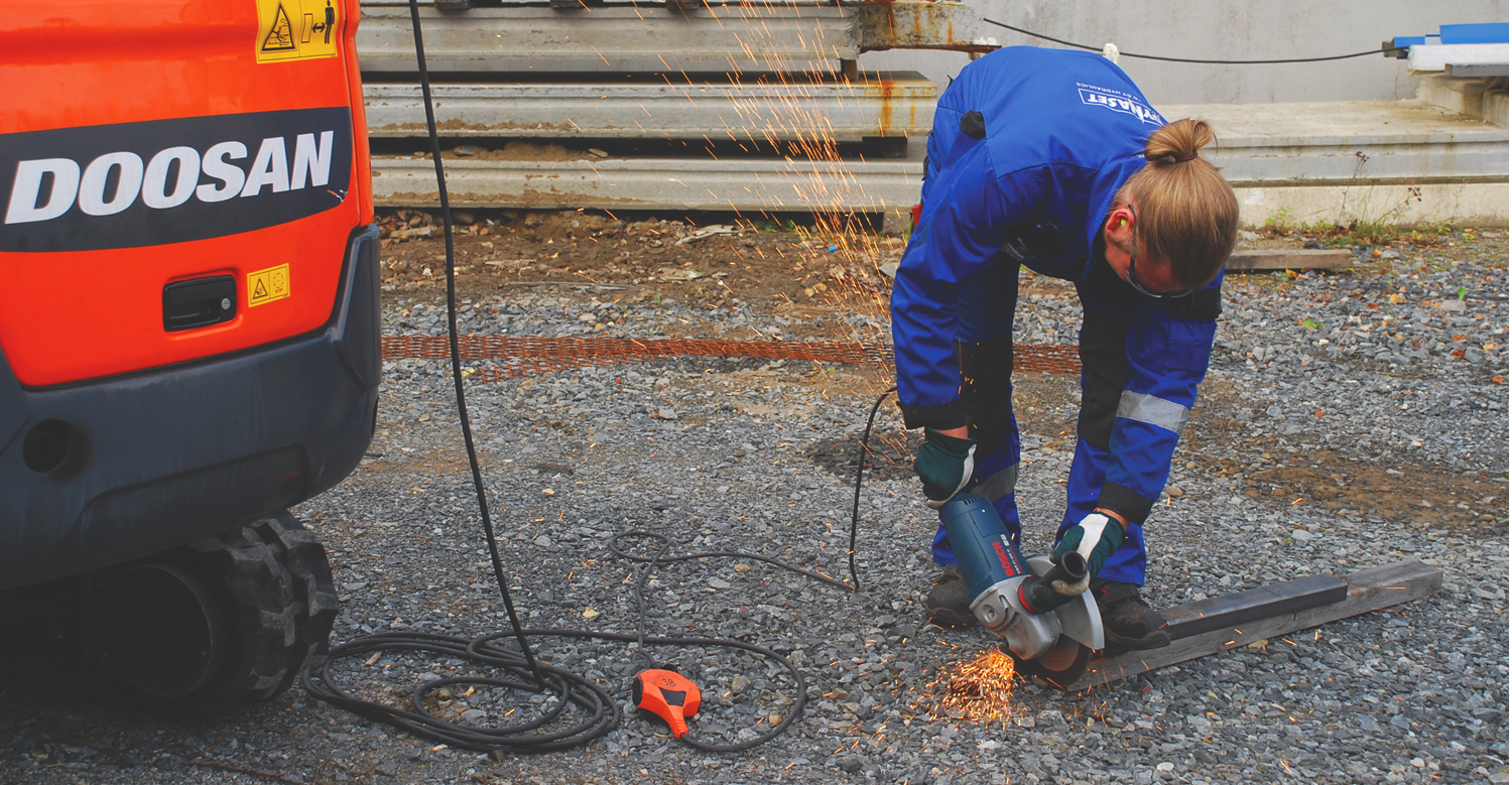

This should come as no surprise, though, because products are widely used at construction sites, mines, waste facilities, and other applications that make extensive use of mobile equipment using hydraulic systems. Dynaset’s products operate simply by connecting a few quick-acting couplings to an excavator’s or other machine’s hydraulic system. This makes the generator much smaller, lighter, and easier to handle than conventional generators, which contain a large and heavy gas or diesel engine, often larger and heavier than the generator itself.
