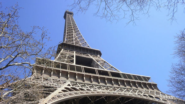

The Eiffel Tower’s hydraulic systems for its elevators were designed and installed more than 100 years ago. Replacing one with a modern system that retained the simplicity of the original also cut energy use by 25%. (Photo courtesy of Bosch Rexroth AG)
