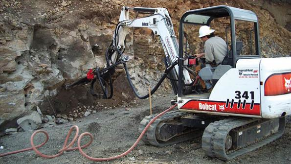

The drilling system is usually sold as an attachment for excavators, mini excavators, shown, skid steer loaders, or loader backhoes. Patterson added, "A one-man portable version is also popular because of its low overall weight and the accessibility into confined drilling areas. These versions, however, require the operator to have knowledge of drill operation for the method being used (rotary, percussion, casing, etc.)."

The TE 250 percussion drill — mounted to a TEI's MME excavator mount — installs tie backs, which are used for anchoring structures to the ground.
