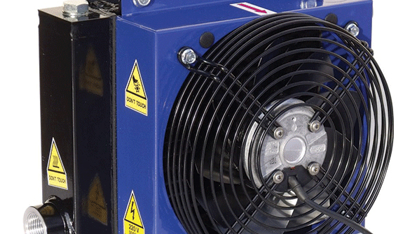

Hydraulic Heat Exchangers
2 To improve cooling, air-to-oil heat exchangers often incorporate a fan to increase air flow.Ridding the system of the heat is the work of the heat exchanger. In hydraulics, there are two basic types: Water-over-oil, as shown in simplified schematic in Fig. 1, and air-to-oil depicted in Fig. 2.

Air-to-oil heat exchangers are vital to mobile equipment because they use the ambient air as the means for carrying the heat from the hydraulic circuit. Just a quick glance at the heat exchanger in Fig. 2 shows its similarity to an automobile’s radiator. They use exactly the same technology, including a fan to stimulate adequate air flow through the radiator cooling coils. Thin vertical tubes carry the hydraulic fluid. Very thin horizontal fins are attached to the tubes, providing heat-radiating area—a good friend of effective heat transfer.
