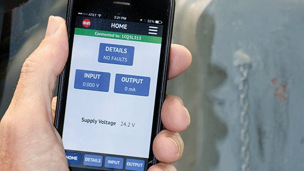

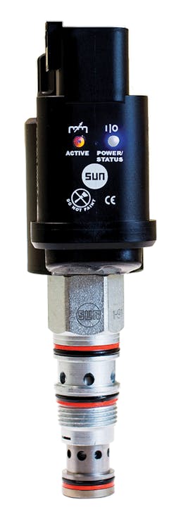

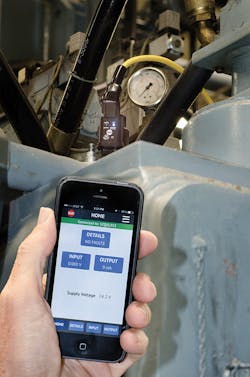

The Bluetooth Embedded Amplifier from Sun Hydraulics (below) features a factory-integrated coil and connector combination for use with the company’s proportional solenoid valves. Users can configure the embedded amplifier wirelessly via Bluetooth using iOS and Android mobile devices for quick, easy, and reliable wireless calibration (above)..

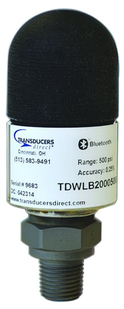

This Bluetooth-certified wireless pressure transducer developed by Transducers Direct is intended for a wide variety of pressure-monitoring applications, including hydraulic systems rated to 10,000 psi. It connects to smartphones, tablets, and PCs with BLE (Bluetooth low energy) and provides long battery life via proprietary technology. Standard full-scale accuracy is ±1%, with ±0.25% optional.
