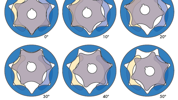

Figure 12 illustrates the relative positions of the inner and outer gears in a gerotor pump. Recall that the blue kidney port is the inlet and the yellow is the outlet. At whatever angle the gerotor is positioned, the design of the outer gear is such that the lobes on the inner are always in near contact with the inside contours of the outer gear.
This near-contact forms a sliding seal and creates expanding and contracting trapped chambers. The chambers expand when in communication with the inlet kidney and contract while in contact with the outlet kidney. In this respect, it’s very much like the vane pumps. The gerotor pump is necessarily fixed displacement.

12. Progressive coordinated rotations of the gerotor set shows how the inter-lobe volumes increase and decrease, and how the inner’s lobe makes new contact with the outer ring’s lobes.
