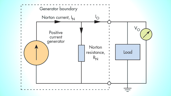

A Norton equivalent circuit contains an ideal current generator (positive current source) in parallel with the Norton resistance, which is an internal parallel flow path analogous to the pump’s internal leakage. It is important to realize that the current generator is not a natural kind of generator. It must be constructed of other elements, such as transistors, operational amplifiers, and the voltage generator.
13. The Norton equivalent generator circuit is a perfect analogy to the hydraulic pump with internal leakage.
Interestingly, one of the first positive-current sources is named after its creator, Brad Howland of MIT. The Howland current pump has obvious similarities to a positive-displacement pump, at least in performance characteristics. But it is not a pump with pistons. Instead, it is an electronic circuit designed to provide a controlled, positive current to some external load.
Figure 13 contains a generic Norton equivalent circuit, and even the most casual observer must be struck by the similarities to Fig. 12. The Norton model of an electrical circuit explains why output current decreases concurrently with an increase in outlet voltage. The culprit is the internal bypass resistance, which takes away current from the ideal Norton generator. It same explanation applies to the hydraulic pump, where internal bypass leakage takes fluid flow away from the outlet port.
